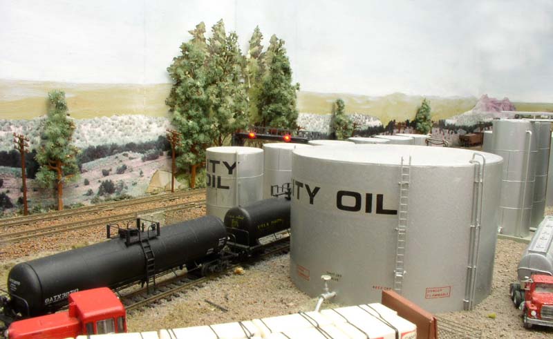

      I think I've got .... seven mirrors at various locations on my layout. After years of putting up with the mirror lines I went to front-surface plastic mirrors and replaced them all. Just love them. See
      https://firstsurfacemirror.com/acryl...urface-mirror/
      Because they are plastic, they can be cut, drilled, etc. My most radical application is a big 12 x 18 mirror where I dive right into a hole cut inside my signal bridge out of the scene. You cannot see the mirror line, the bridge is cut in half and glued right on the hole.
      http://www.randgust.com/flagexit4.jpg
      Half of the tank farm in that view is reflected, mirror is right at the bridge.

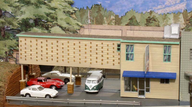

      The way you did yours is great, wouldn't be hard to swap that out with a first-surface mirror and get rid of the dark reflection line at the road edge. They do work. I've even cut vehicles in half and glued them on the mirror and you can't see the line. The VW bus is cut in half in the middle and the Vette is cut lengthwise, both stuck on mirror: http://www.randgust.com/TH14.jpg
