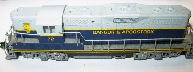

    I have a question in the same vein... I have a couple of the Atlas GP7's in Bangor & Aroostook blue and grey... I just want to be able to remove the lettering, and the herald on the short hoods.
    Actually, it just occurred me that colour matching and careful masking might be better than trying to strip the lettering.
    Still: Anyone know if the same techniques mentioned above can work to remove yellow lettering from an Atlas loco? Is Atlas yellow as evil as Kato yellow remove?

    If you only need to remove a small amount of lettering, is there a recommended way to mask off the rest of the painted shell so the remover doesn't get to it, and hopefully the masking doesn't cause damage either?
