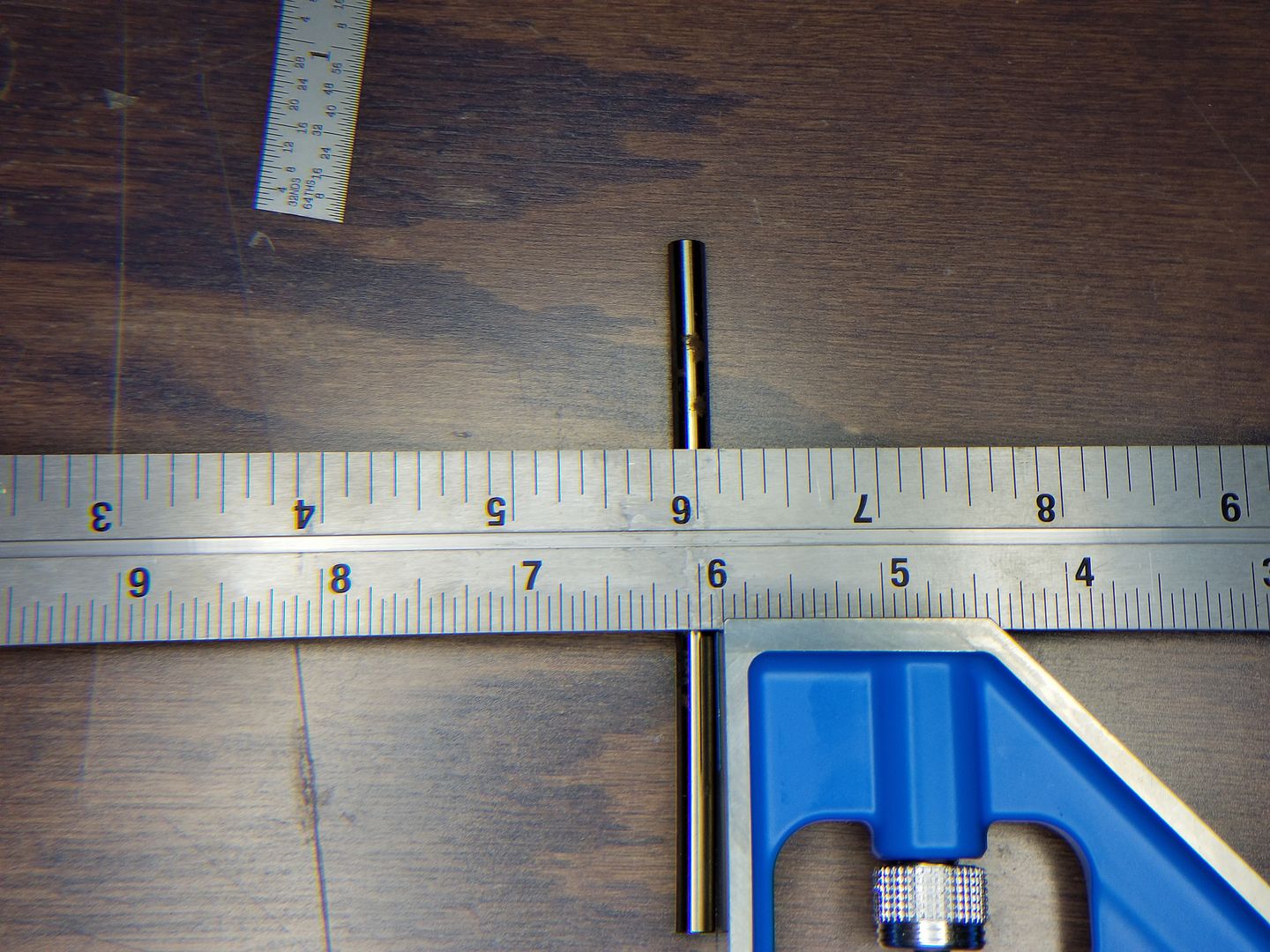

    My balancer is home made from the scale off a 12” combination square, and a .250 drill blank as the fulcrum.
    It kind of looks like a teeter totter with the fulcrum glued to the bottom at the 6” mark.
    The drill blank is attached perpendicular (square) to the scale.
    I found it damn near impossible to hold exactly in the perfect balance (sweet spot) until the glue dries.
    But it’s close enough that some minimum filing on the heavier end edge balanced it.
    The loco is then placed with the center driver (xx-ooo-xx) or the exact middle point between drivers (xx-oooo-xx) centered on the 6” mark.
    That’s what makes the scale work because you can easily see the lines on the scale in relation to the drivers and get it centered on the beam.
    Get the most forward and rear drivers exactly at the same increments from center.
    Then it’s just a matter of placing small amounts of lead on top of the shell until you get the lokie to balance.
    Then take the shell off and glue the lead inside the shell and check the balance again.
    It takes a little trial and error.
    I try to add the lead somewhere over the drivers (domes) rather than out in the smoke box or cab.
    The further away from center the more it seems I chase it to get it right.
    Just packing the smokebox and/or cab with lead really mucks the balance up.
    Lots of folks do exactly that and never balance.
    When the weight is equal over the drivers it gives the best tractive results.
    This is the way I do it and it has worked very well for me.
